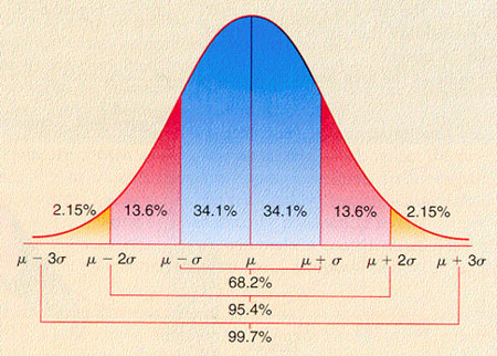

I reopen this threat because the new release of IPC-7352 changes the fabrication tolerances and the placement tolerances to 0.00. Due to this the negative values of the solder joints change  to 0.00, as well.
I can understand the reason to modify the fabrication tolerance value, it has a lot of sense. The pcb manufacturer applies a correction factor to the pcb due to the etching. Creating a footprint with a fabrication tolerance is to apply twice this tolerance.
My question is related to the placement tolerance. Untill now this value was 0.025mm and I cannot understand the reason to modify it to 0.00.
For example if a P&P machine has an accuracy of +/-50um (3 sigma), assuming that the component placement is a normal distribution
I think that it means that:
  • the 68.2% of the components will be placed with a tolerance +/- 17.05 um
  • the 95.4% of the components will be placed with a tolerance +/- 23.85 um
  • the 99.7% of the components will be placed with a tolerance +/- 24.925 um
So the placement tolerance of +/- 0.025 mm is not a value far from the reality.
I am not a designer with so many years of experience like many of the members of Footprint Expert Family and this is the reason why I need your help. I need to understand this subject of tolerances.
Many thanks for help to all of you.
Regards.
David

Post Options Post Options   Thanks (0) Thanks(0)   Quote Tom H Quote  Post ReplyReply Direct Link To This Post Posted: 10 Feb 2023 at 11:43am
Today's pick & place machines have a tolerance of +/- 0.01 mm.
How old is the image that you posted?
The V23 footprint expert allows the user to edit that assembly tolerance to match the age of the machines you use.
However, the pad stack calculations are so subtle that the difference between 0.025 assembly tolerance and 0.00 is too small to be concerned.
