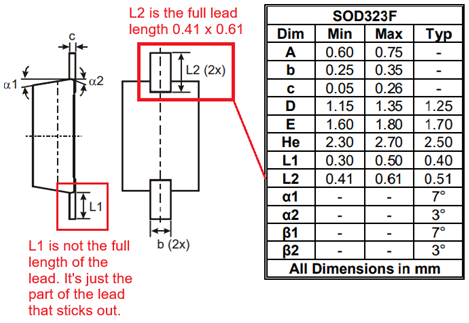

The terminal leads for DFN packages are 100% under the package body.
The Diodes SOD323F is in the SODFL component family.
The SODFL terminal leads are under the body and also protrude beyond the package body.
