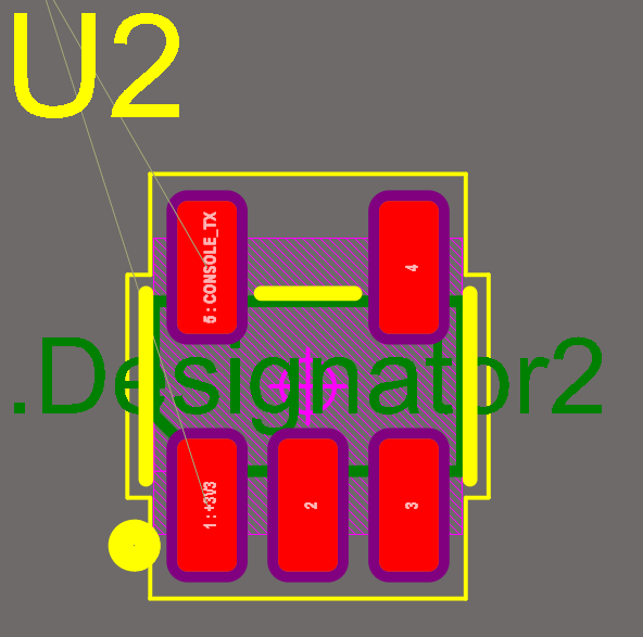

After building a new PC and re-installing everything, I've gone to make some parts.
So using version 25.3, I've generated the build scripts for some resistors - my go to sanity check that I have the settings right.
For some reason, the reference designator text is appearing as .Designator2. I am looking to get the designator onto the assembly outline layer, sized and centered appropriately. I can't seem to figure out why I am getting the 2 suffix, I don't remember that before.
No doubt I've missed something obvious, but I can't find it.

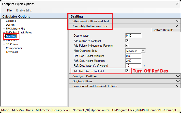

There are two .Designator
One for Silkscreen .Designator and one for Assembly .Designator2
You can turn then on/off in Tools > Options > Drafting > Silkscreen/Assembly
Are you using V25.03 that was released 12 hours ago?

Post Options Post Options   Thanks (0) Thanks(0)   Quote JCurtis Quote  Post ReplyReply Direct Link To This Post Posted: 13 Feb 2025 at 11:07am
Yes, V25.03. Just downloaded the latest as I'm slowly sorting out the PC.
I didn't realise Altium would take a .Designator2 when creating assembly/draftsman outputs. I'll give it a try tomorrow. Is this a new feature?
I've been using PCBLibraries for a few years and not seen before.

The Assembly .Designator2 is a new feature in V25.03.
But you have on/off control in Tools > Options > Drafting

Post Options Post Options   Thanks (0) Thanks(0)   Quote JCurtis Quote  Post ReplyReply Direct Link To This Post Posted: 13 Feb 2025 at 11:19am
That would explain it. Though Altium only specifies .Designator as a special string. I was seeing .Designator and .Designator2 on the different layers.
The docs just say..
  • .Designator – the designator string for a component (placed on any layer in the library editor as part of the component footprint).
When I'm back in the office tomorrow I'll see if Altium treats them both the same and replaces them with the actual component designator when generating the outputs.

Post Options Post Options   Thanks (0) Thanks(0)   Quote JCurtis Quote  Post ReplyReply Direct Link To This Post Posted: 14 Feb 2025 at 12:37am
Unfortunately Altium doesn't seem to accept .Designator2 as valid, and doesn't replace the text with the component designator.
If I edit the text and remove the 2 suffix, Altium renames the field correctly.
I think the the 2 suffix needs to be removed from the field created in the footprint.

Post Options Post Options   Thanks (0) Thanks(0)   Quote JCurtis Quote  Post ReplyReply Direct Link To This Post Posted: 15 Feb 2025 at 8:02am
Just to close this off. The issue has been identified and swiftly fixed by the PCBLibraries team. If you see this problem, simply re-download V25.03.
