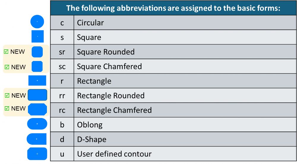

Updated Pad Stack Naming Convention released in IPC-7352.
The first letter in the pad stack name describes the shape of the pad on the outer layers of the circuit board. Small letters are used. Note: “b” = Oblongs, because the letter “o” could easily be confused with the number “0”.
