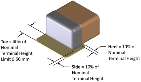

In 1990, the EIA standards organization created the PDP-100 publication, which documented chip package case codes Length and Width dimensions, but not package height. If chip component manufacturers used the same height for each package case code, it would further reduce footprint duplication. For instance, 0603 chip capacitors are normally thicker (average 0.90 mm) than 0603 chip resistors (average 0.50 mm). It would be acceptable to define an average package height for each component family and case code. This would create a different footprint for each component family for Capacitor, Resistor, Inductor, Diode, etc. because they all have different 3D STEP models anyway.
These pad stack calculation percentages of terminal height have a tolerance of +/-5% and are reasonable for ensuring simple, clean, consistent, and reliable libraries.
EXAMPLE 1 - Rectangular End Cap (Chip) Leads:

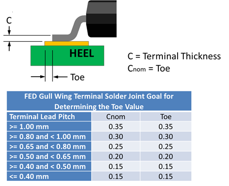

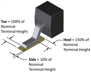

EXAMPLE 2 - Gullwing Leads:
PCB Libraries, Inc. added the Nominal Calculation Mode to Footprint Expert V25.02 as an alternative land pattern calculator in January 2025. Users can switch back and forth between IPC-7352 and the New Proportional Land Dimensioning Concept.
Create IPC or FED compliant footprints using package dimensions and your personal Options for pad stack rules, drafting outlines and solder joint goals.

This is where the New Proportional Land Dimensioning Concept comes in. It enables the calculation of the suitable land on the circuit board in proportion to the size of the component terminal, considering the physical properties of the soldering process: wetting, capillary action and force transmission. In their interaction, however, they cause the solder meniscus and coverings specified in the applicable standards under reliability aspects without unnecessarily or negatively affecting too large pad areas.
The starting point for the proportional concept is the requirements at the solder joints as described in J-STD-001 and IEC 61191–2 on the one hand and a new specified simplified classification of components, according to their terminal types on the other.
While the IEC land pattern standards as well as the IPC–7351B differentiate the components according to package families, the proportional concept is based on a two-stage classification according to terminal types.
