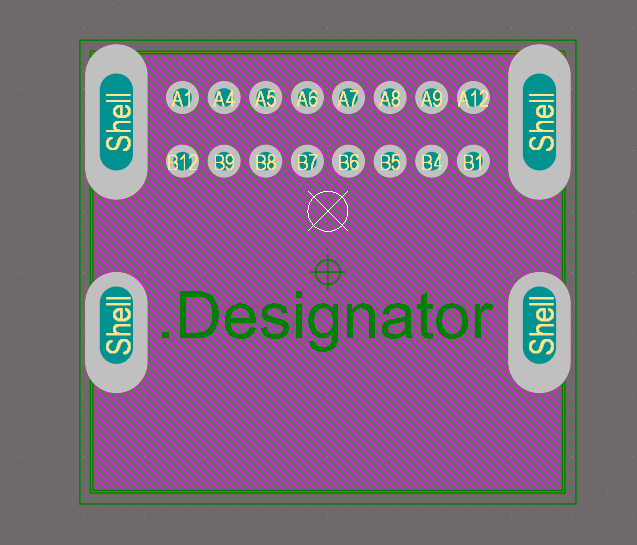

Hi AGONZ67,
We are using in the next way, the center of the component is the copper center.
In the courtyard mechanical layer we place another center mark that is the center of the rectangle of the courtyard.
Waiting your comments, this is an interesting discussion.
Regards
david

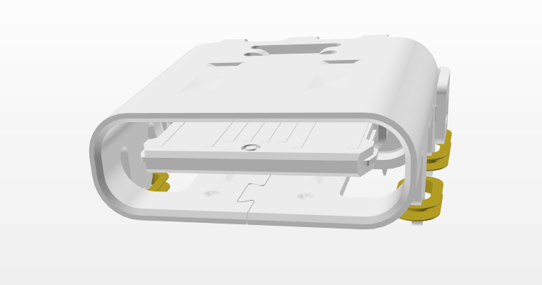

PS: the attached pic are related to 2137160001 Molex connector
